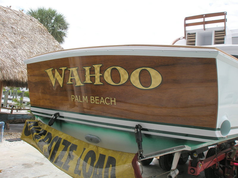

I'm not sure if this still works, but Marlin had some beautiful pics of his gorgeous teak transom here.

Marlin's teak transom looks great and your transom looks great the way it is...either way, its a win.

Post by Rick Kral »
Gert,
I thought i would share some preliminary photos for your consideration. I opted for side exhaust when I realized I needed 6 inch exhuast to accomodate my motors. I felt the bigger tubes would have been out of place on the transom and routing would have taken up more under deck storage. i was also concerned about "surge". The exhaust is custom from the turbo back. i received some great advice on the exhaust from Bob Lico and the Cpt. as for surge tubes and routing. I also decided to use mahogoney on the transom as i could not swing a solid peice of teak that makes up the beautiful transom on Wahoo. The material below the water line is Coosa. As you can see i am just begining my rebuild. Things are coming along and i am happy to share my hard learned lessons if you decide to proceed. You will also notice the Cpt.'s helm pod in the second photo. I also included a photo of the Cpt's. fish box that I used when I built the transom. As much as i would have preferred to build these parts i also want to finish the project for next spring launch (not to mention the Cpt's. work is top notch). Seeing your boat and many others on this site is insperational. i am not sure i would tear up a beautiful boat like yours to add these components. Good luck with your decision.
Rick

Post by Morning Wood »
Nice...... Very Nice. Wood is good!
