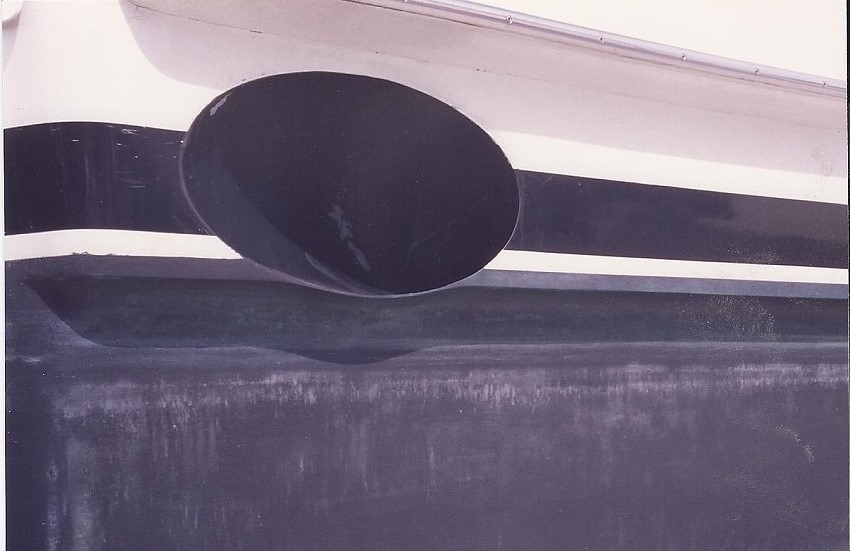

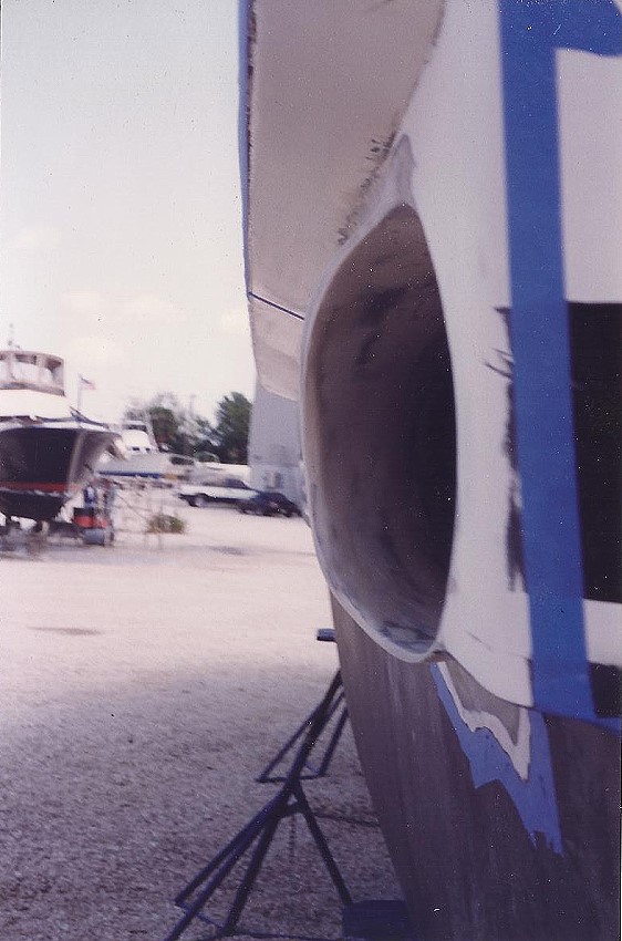

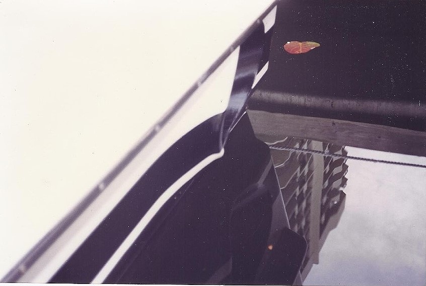

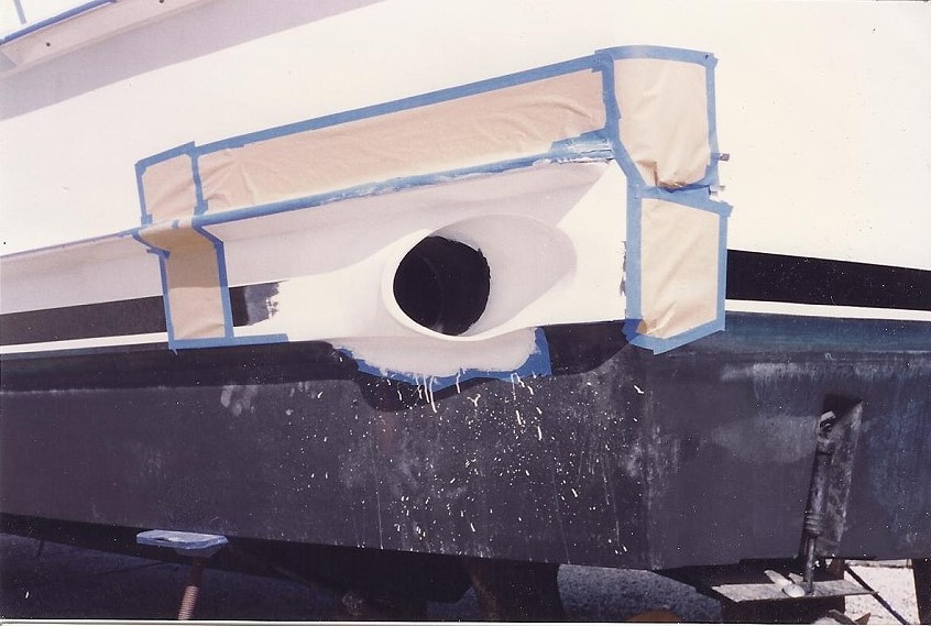

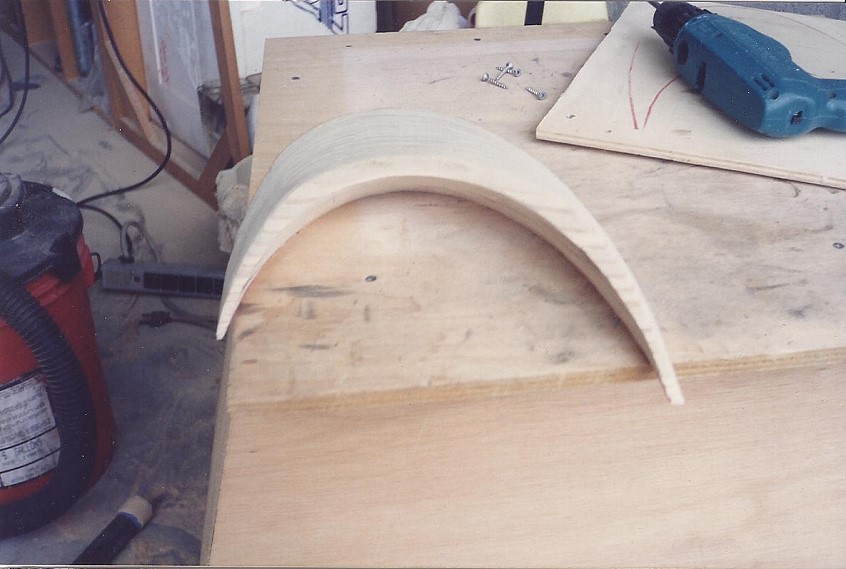

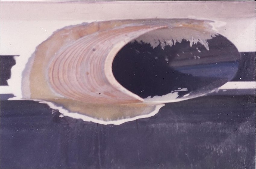

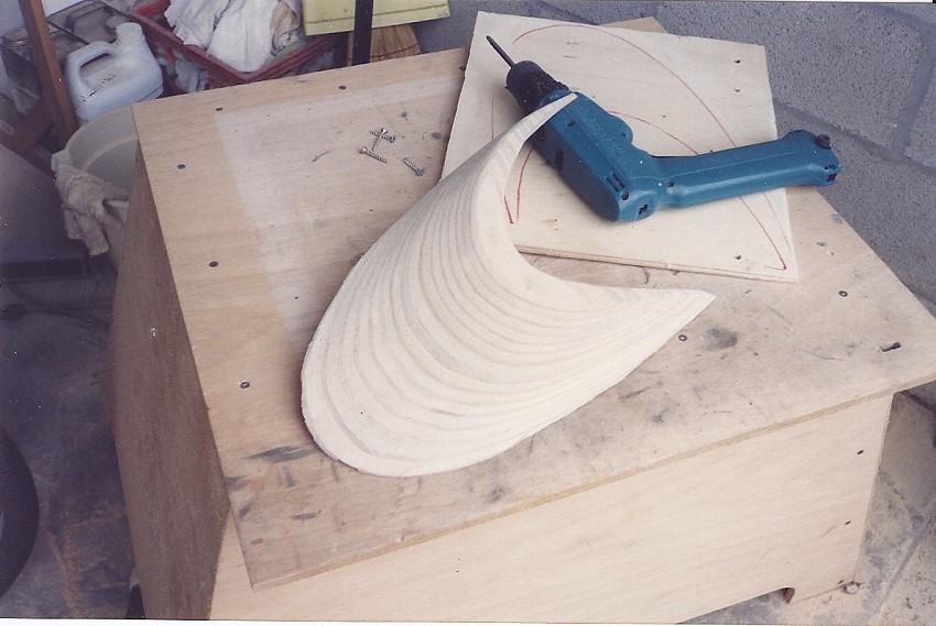

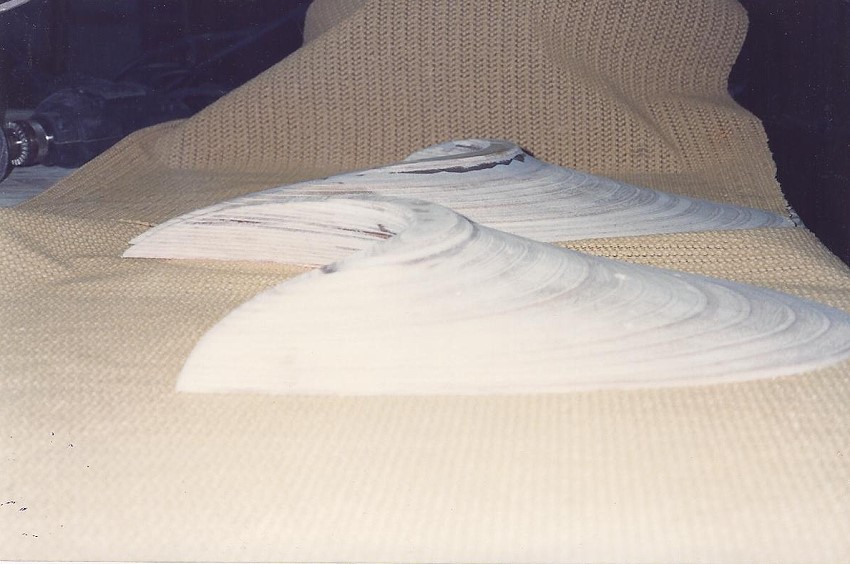

What are your thoughts on side exhaust with or with out surge tubes? seems to be a point of debate.
I personally don't like side exhaust... But if you do go that way, make solid flares on the forward half to deflect water flow when in forward gear at less than planning speed. Water flowing directly over an un-flaired, (flush), side exhaust port can create significant back pressure...
This is a set of flairs I did on a 50 Hatteras back in the dark ages...
Flush side exhaust
plywood build up
mounted
