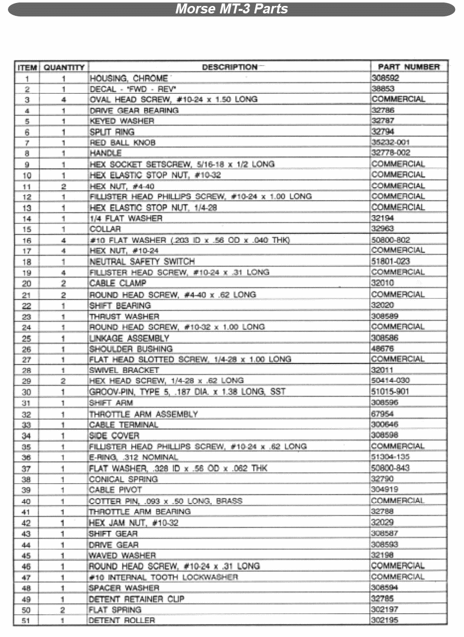

I broke down a Morse MT3 control to use on Patrick Hancock's B31, inside of my console bubble. The two problems to overcome are devising a mounting system and lengthening the control arm shaft. The shell of the control isn't flat so you'll have to make a custom shim to fit between the shell and the inside of your bubble.
http://www.bertram31.com/hancock/img/br ... s/mt-3.gif
http://www.bertram31.com/hancock/img/br ... -parts.gif
Check ebay: http://www.ebay.com/itm/Teleflex-Morse- ... 640wt_1157" onclick="window.open(this.href);return false;

Re: single lever controls
Jimmy,
The one in Pats .pdf is what glen is modifying for the L&H helm pods. I think he keeps a few around for one off projects. Might be worth a phone call down there, beats reinventing the wheel.

I believe the boat has that morse control and i had thoughts of digging it out of my junk pile and trying to modify it, thank you as always your a great wealth of information! JP thats not a bad idea where is L&HCaptPatrick wrote:JImmy,
