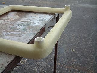

Dave & Jerry,
I use 3/4" PVC couplings for the drains, (2 per hatch opening, both aft). I first tack them into place with super glue, then glass them at the base with three layers of 1 1/2 oz mat.
Once set, it's a simple mater of plumbing with 3/4" PVC pipe and fittings...
The following page(s) are of a pair of custom hatches I made for a 60" power cat.
Power Cat Hatches
